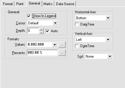

Hello all,
Is it possible to embed the series format panel into another dialog?
What I want to so is have the panel below (Format, Point, General and Marks (I don't want "data source")) in my own dialog so a user can format the series.
Thanks in advance,
Tony.
Thanks in advance,
Tony.

Yes, I use the chart editor already.
But I would like to be able to just give the user formatting options for a particular series (so not even let them select the series). All I really want them to see is "format", "point", "general" and "marks", is there any way of doing this?
So far I've duplicated the functionality in my own dialog, but if it can be done already I will use that.
Tony.
Tony.
