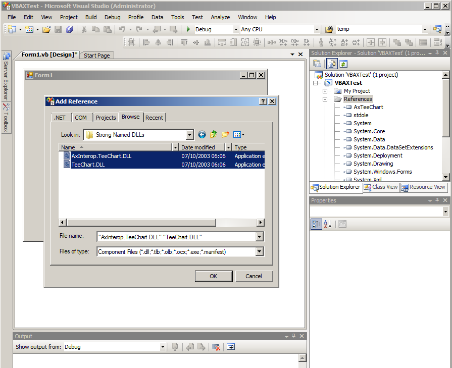

Second problem, I can't build by VB.NET application. I can add references for TeeChart but I cannot add references for AxTeeChart which are present when built with TeeChart 5.
So I tried to build an TeeChart example from C:\Program Files\Steema Software\TeeChart Pro v8 ActiveX Evaluation\Examples\Visual Studio .NET\VBasic\Adding Series Project and after fixing the references I find that it is using TeeChart 5 not 8.
Third problem, I can't build the example with TeeChart 8 because I can't define a reference for AxTeeChart.

2. How do I add a reference to AxTeeChart in VS2008 to VB.NET?

Regarding the VisualStudio projects, you should use the strong named dlls on them (AxInterop.TeeChart.dll and Interop.TeeChart.dll), not directly the ocx. You should find them at:
"C:\Program Files\TeeChart Pro v5 ActiveX Control\Utilities\VS.NET\Strong Named DLLs"
"C:\Program Files\Steema Software\TeeChart Pro v8 ActiveX Evaluation\Examples\Visual Studio .NET\CSharp\Dragging\obj\"

Bruce.McDowall wrote:2. How do I add a reference to AxTeeChart in VS2008 to VB.NET?
In the "Solution Explorer", right click on "References" (with "Show All files" selected) and go to "Add Reference...". Then, browse to the dlls:

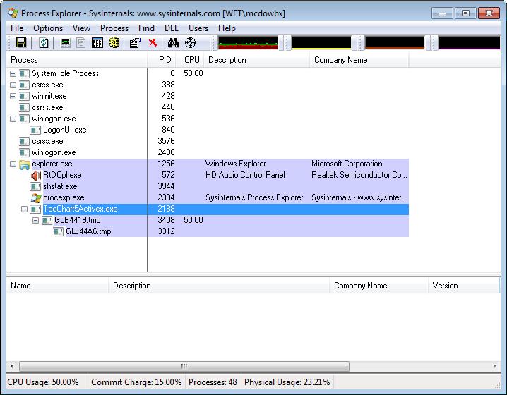

I copied the 5.0.6 example from my development PC to a deployment PC. The example does not display a window but remains in the task/process list.
I tried to install TeeChart ActiveX 5.0.6 on the deployment PC but the installation hangs and appears to be active in the task/process list. If it is killed then the uninstall fails.
TeeChart installation procex.JPG (65.39 KiB) Viewed 9288 times
This is a Windows 7 Enterprise system and the user has administrator rights.

It should work simply copying the application and the ocx to the second machine and registering the ocx.
Of course the installation of TeeChart registers the ocx, and it should work fine. If it doesn't it will probably be due to an antivirus, antispyware, registry-blocker,... that doesn't allow the installer to run properly.
