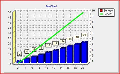

Sorry, I thought that I could use this properties to set my custom axe at right exactly like the left axis.
Thank you
Rousseau
Posts: 31
Joined: Fri Oct 13, 2006 12:00 am
Location: St-Jean-Port-Joli, Canada
Re: Minimum Maximum, Custom Axes
Post by Rousseau » Mon May 17, 2010 5:36 pm
I used the property OtherSide.
    TChart1.Series(1).VerticalAxisCustom = TChart1.Axis.AddCustom(False)
    TChart1.Axis.Custom(0).SetMinMax 0, 50
    With TChart1.Axis.Custom(0)
        .OtherSide = True
        .AxisPen.Color = vbGreen
        .Title.Caption = "Extra axis"
        .Title.Font.Bold = True
        .Title.Angle = 90
        '.PositionPercent = 50 'Don't need to use this property if you use otherside
    End With
It's perfect. Thank you
