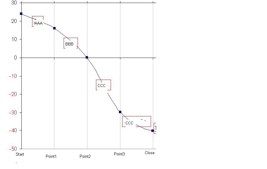

I need to get two things in my Line graph. Attached is a sample to show what I am looking for.
1. Is it possible to have label in between the points? In my eg:- lables like "AAA","BBB" etc.
2. To have labels in my X-axis (I need to put text as labels). In my eg: - "Start","Point1","Point2" etc.
If I add using Chart.Series(0).Add 20, "AAA", RGB(0, 64, 128) Then "AAA" comes near the point.
I was able to do the 2nd requirement using .Axis.Bottom.labels.Style = talMark.
I need a combination of points 1 and 2.
Can you tell me what settings I need to do to set this.
Any help on this will be really helpfull.

- This is what I am looking for.
- DifferentLabelsInAxis.JPG (24.9 KiB) Viewed 18168 times

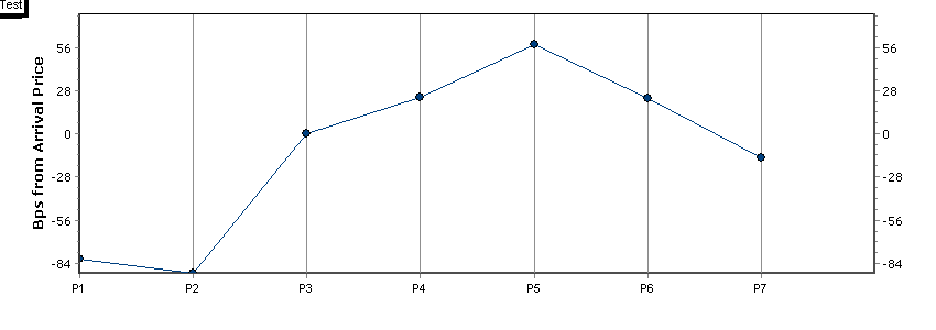

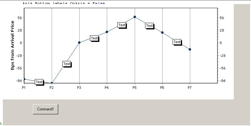

I tried to use Annotation but I am not able to plot Annotation in the middle of the points.
It works fine when I run the cod eand view the output but when I Export that image to jpeg the points are not on the same Location.
Also I have attached both the screenshot.

Re: Labels in between points in line chart
Hi CS,
You could try exporting the chart to an image using TChart1.Canvas.StretchDraw method.
I am using TChart Version 5 in Visual Basis.
I can't find StretchDraw Method in this version.
Can you give me some other solution to fix this.
CS
CS
Hi CS,
StretchDraw is available in v2010 (aka v9). Many new features and enhancements have been added since v5 was released. We strongly recommend you to have a look at v2010's fully functional evaluation version available at http://www.steema.com/evaluation/ax.
An alternative to StretchDraw, which can be done in v5 too is positioning object in the OnBeforeDrawSeries event. Doing so exports tools correctly. You should remove the code where you add tools and do something like this:
Private Sub TChart1_OnBeforeDrawSeries()
TChart1.Tools.Clear
For i = 0 To TChart1.Series(0).Count - 2
TChart1.Tools.Add tcAnnotate
With TChart1.Tools.Items(i).asAnnotation
.Text = "Test"
.Shape.CustomPosition = True
.Shape.Left = ((TChart1.Series(0).CalcXPos(i + 1) - TChart1.Series(0).CalcXPos(i)) / 2) + TChart1.Series(0).CalcXPos(i) - (TChart1.Canvas.TextWidth(.Text) / 2)
.Shape.Top = ((TChart1.Series(0).CalcYPos(i + 1) - TChart1.Series(0).CalcYPos(i)) / 2) + TChart1.Series(0).CalcYPos(i) - (TChart1.Canvas.TextHeight(.Text) / 2)
.Shape.Transparent = False
End With
Next i
