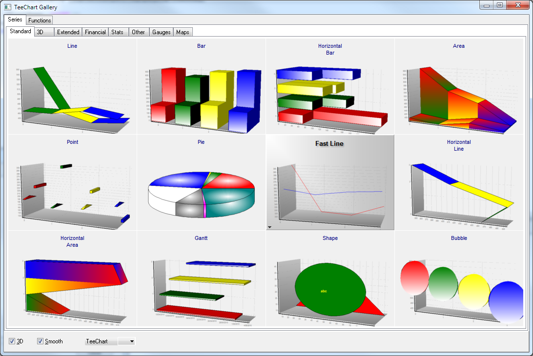

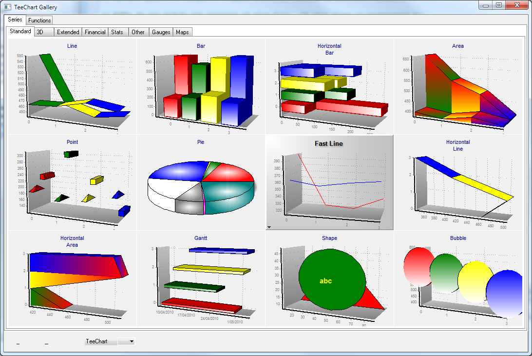

I registered the new ocx but am still receiving the error. I'm beginning to think that I'm calling the wrong methods for what I'm trying to do so I'll back up a little.
On the TChart Editor there is a little check box on the bottom left hand corner called "Smooth". When I click that it seems to smooth out the appearance of the graphs. What is the methods I need to call in C++ to emulate this behaviour?
I've attached screen shots for clarity.

n00b

Post by n00b » Thu Apr 08, 2010 1:02 am
Thanks figured it out but won't be using it for my implementation.
For those interested, the code in c++ is:
myChart1.GetCanvas().SetUseAntiAlias(TRUE);
