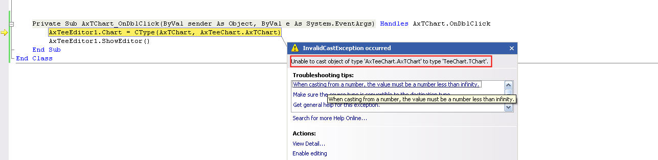

I would like to use the ActiveX Teechart Editor control with .Net.
I have this beautiful cast error (see attached image)
How can i do that ?
Thks a lot for your help

Hi Guilz,
Try using CharLink as in here.

works like a charm.
