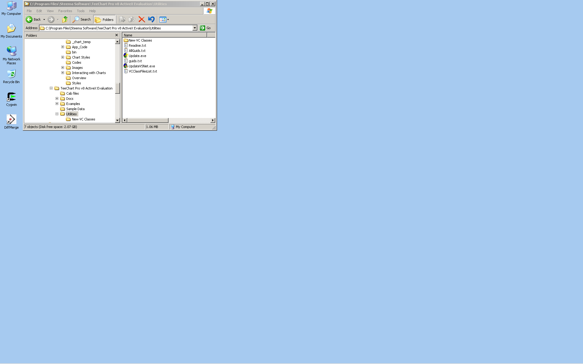

I'm sorry but the path:
"C:\Program Files\Steema Software\TeeChart Pro v8 ActiveX Control\Utilities\Vs.net\Strong Named DLLs"
does not exist for the demo version.

Re: AxTeeChart references missing in newer ActiveX?
No solution to this? Product doesn't support this class anymore?
Hi Paula,
You are right. Until now, the ActiveX evaluation version didn't include this folder. We will include it in the next versions.
If it is really necessary for you, we could try to prepare them for you and send it.
