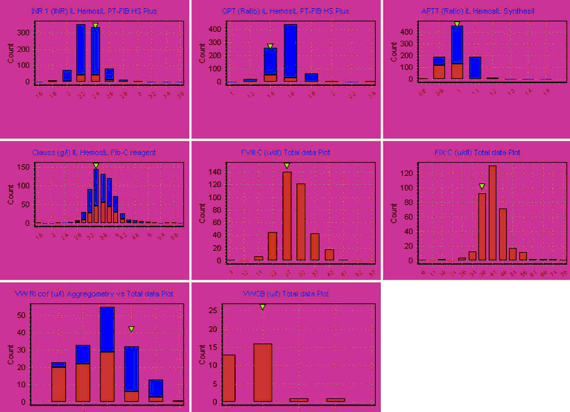

I have a small problem that I can't find an answer to. Using VB6, Active Reports STD and TeeChart Pro 8
I have an Active Report that shows a series of TeeChart Pro 8 graphs that represent laboratory test. Each test graph show on the bottom axis the results obtained for analysis, and the left axis shows the number of observations. The results are obtained from a SQL Server 2005 database,and all works as expected. Please see my attachment.
The TeeCharts are drawn onto an Active Report form, and all are drawn the same size. However, when data fills the graphs, some of them shrink..as shown by the attachment that I have supplied. I don't want them to shrink.
I have set the bottom and Left axis Min, Max and Increment to Auto because I won't know in advance what the values for the X and Y axis will be.
I don't think that this is a coding problem, I think that the graph is automatically adjusting it's size to fit the increments on the Left axis..which I don't want it to do.
Thank you for your time.
Any help that you can give will be appreciated.
David

- Reagents.jpg (188.48 KiB) Viewed 29991 times

Sorry..I omitted to show you the graph with the panels coloured to demonstrate that it is the ChartRect that is shrinking
David
David

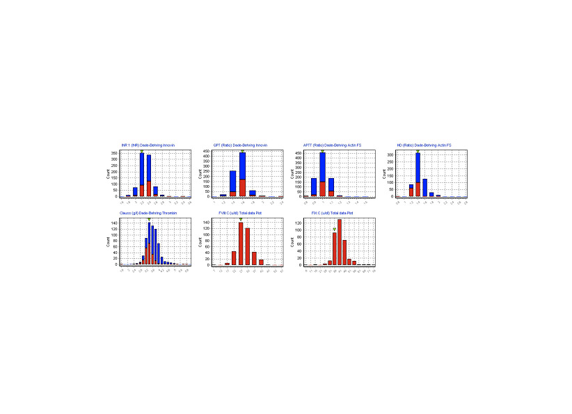

- Reagents2 Coloured panels.jpg (141.88 KiB) Viewed 29902 times

Re: Graph Sizing
Hello Yeray
No, I can't get the .Align property to show. I have checked and my TChart reference is registered..obviously otherwise I wouldn't be able to render my graphs! I have not installed the latest service pack as I would then have to re-check ALL of my reports to ensure that they are rendering correctly...see my last problem re Active Reports and strange rendering. So, I'm not sure why the .Aligh property is not showing.
I have found the problem with the "shrinking ChartRect:
My graphs show Overall Reagent values using previously calculated and stored increment steps plus individual reagents using the same previously calculated increments that make up the total Overall Reagent result within a particular increment range. These values are represented on using the Stacked bar graph. I then plot the individual participants value..(using their reagent) at the top of the appropriate Stack Bar. To get the individuals increment value, I need their result and then I have to compare it to a re-calculated increment so that the marker sits above the correct bar on the graph. I was assigning the re-calculate x-axis value onto the same graph. The figures for the previously calculated and the re-calculated values are the same, but obviously something is wrong. Either way, the x-axis values remained the same, the individual marker is in the correct place, but the graph had shrunk.
My code is as follows..original first followed by my correction:
'*Shrinking Graph code
Private Sub QPT_Graphs()
TChart3.Visible = False
TChart3.Series(0).DataSource = "" '*Clear out any old datasource
TChart3.Series(1).DataSource = "" '*Clear out any old datasource
TChart3.Series(2).DataSource = "" '*Clear out any old datasource
TChart3.Header.Text.Text = "QPT"
Set rsGeneric = Graphs.Get_Report_Variable_Graph_Data(Survey, LabID, GraphPrefix & "Graph_Data_QPT", "ReagentID", ResultPrefix & "QPTResults", "INRReagent", "Reagent")
If rsGeneric.State = adStateOpen Then
If rsGeneric.RecordCount > 0 Then
Position = Position + 1
Position_Graphs TChart3, Position '*Position the TChart
With TChart3.Series(0)
.Color = vbRed
.asBar.MultiBar = mbStacked
.DataSource = rsGeneric
.YValues.ValueSource = rsGeneric.Fields(2).Name '*The Y Axis (Count)
.LabelsSource = rsGeneric.Fields(1).Name '*The X Axis (Increment)
.Marks.Visible = False '*Don't show the individual values for each point
.ShowInLegend = False '*Don't show the Series title
End With
With TChart3.Series(1)
.Color = vbBlue
.YValues.ValueSource = rsGeneric.Fields(3).Name '*The Y Axis (Total)
End With
TChart3.Header.Text.Text = "QPT (Ratio) " & rsGeneric!Reagent
'*Now fill in "Your Result"
Set rsGeneric = Nothing
Set rsGeneric = Graphs.Plot_Your_Screening_Result(Survey, LabID, GraphPrefix & "Graph_Data_QPT", ResultPrefix & "QPTResults", "Ratio")
With TChart3.Series(2)
.Color = vbGreen
.YValues.ValueSource = rsGeneric.Fields(1).Name '*The Y Axis (Total)
.LabelsSource = rsGeneric.Fields(0).Name '*The X Axis (Increment)
End With
End If
Else
End If
End Sub
'*Correctred Graph code
.Color = vbRed
End With
.Color = vbBlue
' .LabelsSource = rsGeneric.Fields(1).Name '*The X Axis (Increment)
End With
.Color = vbGreen
' .LabelsSource = rsGeneric.Fields(0).Name '*The X Axis (Increment) TAKE THIS LINE OUT AND ALL IS WELL!!
End With
End If
Else
End If
End Sub

- Corrected Reagent Graphs.jpg (65.92 KiB) Viewed 29882 times

Yes, using the "Correct Graph Code" does correct the shrinking problem. Adding the LabelSource in the "Your Result" section produced the error (highlighted in red and bold in my code.

Hello Yeray
I think that I have found the answer!
If I type TChart1.ChartRect 20,30,40,50
instead of TChart1.ChartRect(20,30,40,50)
then all works OK.
From the help file, it is is implied that the syntax should be TChart1.ChartRect (30, 40, 50, 60)
Also, another discovery: the TChart1.Align shows on a VB6 form, but not on an Active Report (ActiveX)
I have attached a new zip for you to look at..just go to the AR and type TChart1.Align and you will see that it is not presented as an option.
David
