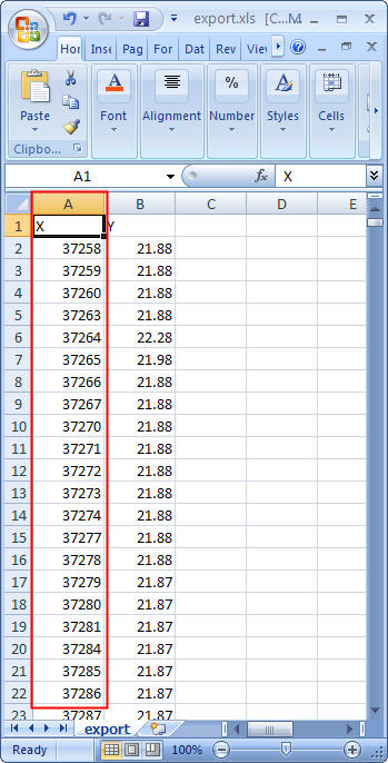

If I export my Teechart chart data with
.Export.asXLS
My date are not showing correct format

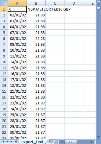

Now, If I export data with following code
.Export.asText

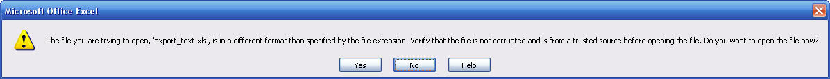

My date are in correct format but when Excel is launching I've the following alert message:

Yes, I've verified that this error appears in office 2007.
So, as you've seen there are two possibilities:
- asXLS: works without any error at all. But, as Narcís explained, as delphi saves the numbers as doubles, you'll see doubles instead of dates in the first column. And then you can set this column to Date format in Excel.
- asText: gives a format error in Office 2007 but it still opens the file and displays all the columns as you had them in TeeChart as it saves the strings.
