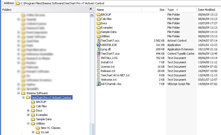

Re: Zooming by code on a date range
I use Teechart with VB6.
Screenshot of the directory attached.
You speak about TScrollBar: what is the difference with TChartScrollBar ?
I don't have TScrollBar too
Guilz
Guilz
- Teechart.jpg (76.64 KiB) Viewed 19382 times

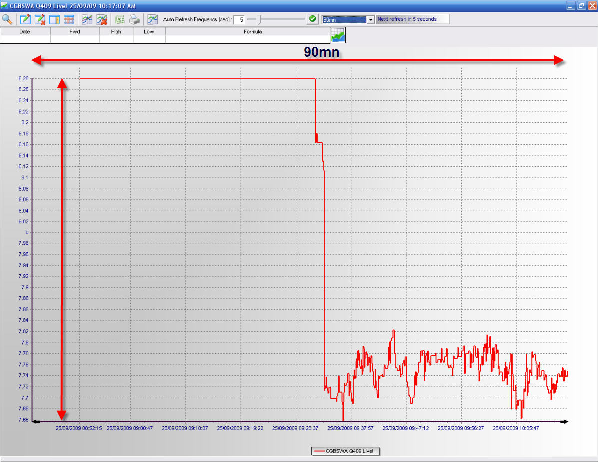

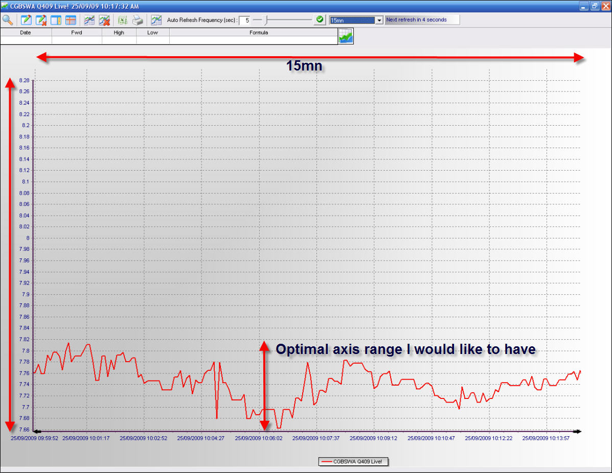

Another day, another question
How can I adapt automaticaly optimal axis range (left axis) when I use setminmax function to zoom on a specific range (bottom axis) ?
Have a look to my screenshot, easier to understand.
Thanks for your help
Guilz
Guilz
- t1.jpg (181.55 KiB) Viewed 19366 times
- t2.jpg (189.01 KiB) Viewed 19367 times
Hi narcis,
my axis automatic property are set to true but it does not reflect minimum and maximum values for the range define by setminmax method on bottom axis only -> on Left axis, min max values reflecting entire content of the graph.
Hope it help you to understand my problem
Thks a lot
Guilz
Thks a lot
Guilz
