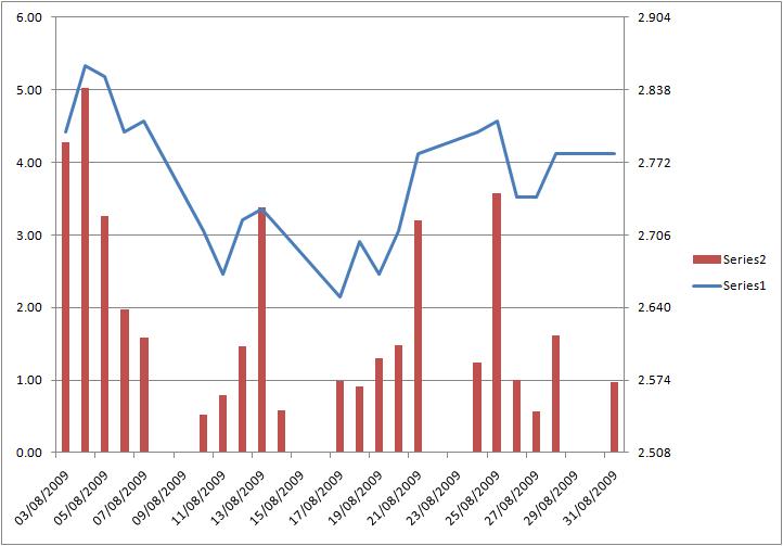

Actually I use Teechart 7 version and Visual Basic 6. I need draw two series, one of them a bar style in left axis, and the other line style in right axis. I need a graph similar to image (attach), is this possible? And I can set the number of points in the scale? (In this example 6 points), because when set min and max values por left and right scale, the rght scale don't start in the bottom axis, and the graph have difent lines in left and riight axis. Thanks in advance

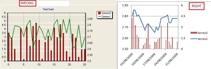

Thanks for your reply. I try your solution, but not fix my problem. I need, equal lines in right and left axis, i will attach an image with the example. And other question, I can set the number of intervals in the graph? I changed the increment value in the left and right axis calculating this value (in other example), but the right axis not start in the bottom axis, and the lines in left and right axis is not equal. Thanks for your time and patience.

Post by Yeray » Wed Oct 28, 2009 10:09 am
Hi Daniel,
Here is what I'm getting with the code suggested above in TeeChart v8.
I'm afraid I can't think on a way to do this in v7.

Post by Daniel » Wed Oct 28, 2009 4:13 pm
Hi Yeray
Is true, I tried in v8 and work fine. Thanks. I'll update my version

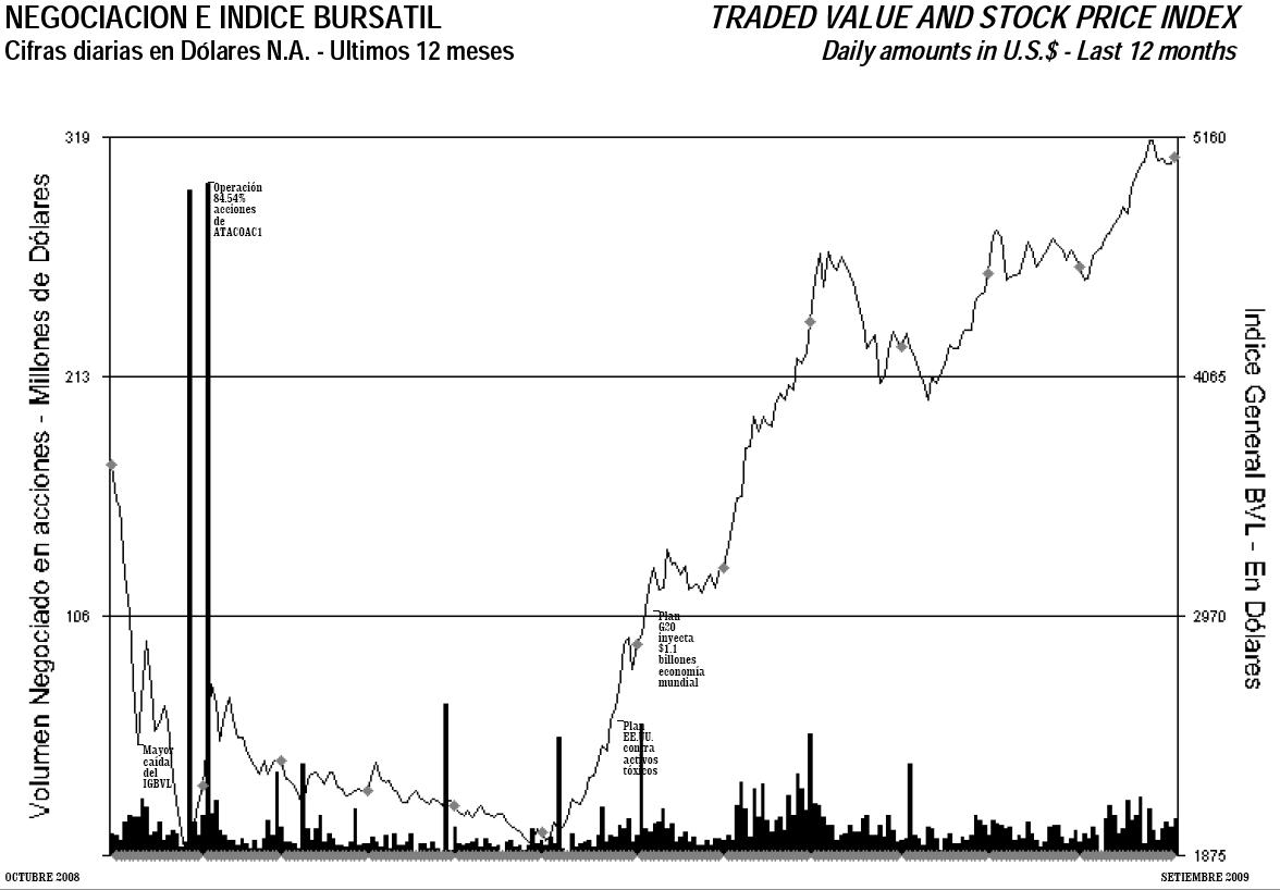

- Is possible create a graph, with comments in a few points? (like picture1)

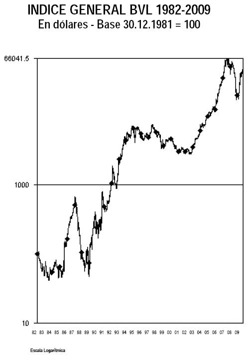

- If I have a graph with logarithmic scale, how can I controll the number of points in a scale, for example if I want only 3 points (like pincture 2)

Daniel wrote:- Is possible create a graph, with comments in a few points? (like picture1)
Yes, you can use annotation tools and you can update their positions at OnAfterDraw event if you want them to be repositioned each time the chart is redrawn.
Daniel wrote:- If I have a graph with logarithmic scale, how can I controll the number of points in a scale, for example if I want only 3 points (like pincture 2)
Do you mean the left axis labels? You can use custom labels, for example:

Daniel
