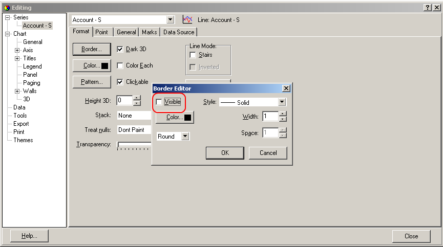

How do I set the series border visibility to true with code?
Re: Panel BackImage Filters
Post by Narcís » Fri Sep 04, 2009 10:02 am
Hi Otokon,
If your series is a Line series try using this:
			axTChart1.Series(0).asLine.LinePen.Visible = true;
Hope this helps!!

Post by Otokon » Fri Sep 04, 2009 10:23 am
Hi Narcís,
I tried your code, but I'm still not able to set border visibility to true. I'm able to set Outline visibility though.
//works
MyChart.Series(0).asLine.Outline.Visible = true;
//dont work
MyChart.Series(0).asLine.LinePen.Visible = true;
Any suggestions?
Post by Narcís » Fri Sep 04, 2009 10:31 am
Hi Otokon,
Try this then:
			axTChart1.Series(0).Pen.Visible = false;
Post by Otokon » Fri Sep 04, 2009 10:59 am
Hi Narcís,
Sorry man. But it still doesn't work.
Post by Narcís » Fri Sep 04, 2009 11:03 am
Hi Otokon,
Can you please attach a simple example project we can run "as-is" to reproduce the problem here?

Post by Otokon » Fri Sep 04, 2009 11:34 am
Hi Narcís,
The problem was at my side, "TChart1.Series(0).Pen.Visible = true;" does work.
