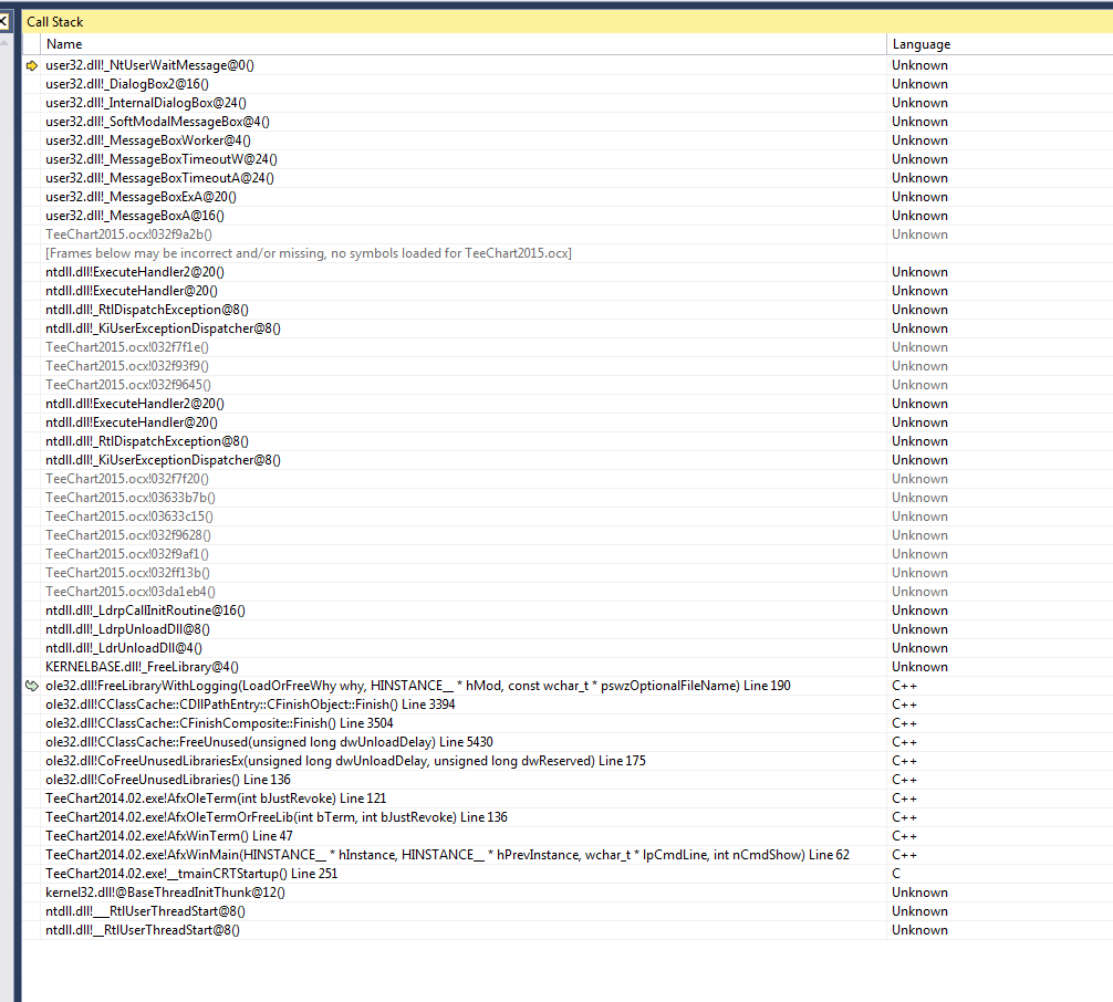

We've tested also on other machines and we still get the problem.
I attached a picture with the stack trace of the dump file from our demo project crash.

The cause of the problem has been identified and we are working on a fix. It's taking some time to identify a working solution as what seems to be required on Japanese systems is contradictory to what is suitable on other systems. We'll make a test version available when we get to a viable proposal.

Post by Yeray » Thu Apr 23, 2015 10:35 am
I'm sending a new pre-release version of the ocx to the mail account you have registered in this forum.

Post by Micro » Mon Apr 27, 2015 3:01 pm
Thanks, it's working.
