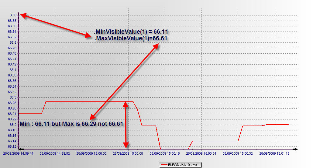

Thanks Yeray but It does not work.
Look at my example:
MaxVisbileValue does not return the current Max Value of my visible graph (zoomed). It return 66.61 instead of 66.29

Post by Yeray » Mon Sep 28, 2009 1:42 pm
Hi Guilz,
Have you called the function
tChart1.Environment.InternalRepaint
before looking at the value at MaxVisbileValue?
Could you please send us a simple example project we can run as-is to reproduce the problem here? Thanks in advance.

Yeray,
Yes I use the
function before.
I build a new sample projet and it is working like a charm :twisted:
I don't understand why it is not working in my 'big' project...Now, I must compare the 2 projects to find the differences.
Thks a lot for your help :wink:

Post by Guilz » Mon Sep 28, 2009 2:32 pm
found it !
Not working if we use
TChart1.Series(0).XValues.Order = loNone
I use this code because I found it in your tutorial about how to increase performance in Real Time.
Not compatible with what I'm looking for :mrgreen:

Post by Narcís » Mon Sep 28, 2009 2:33 pm
Hi Guilz,
That's probably because you need to set it before populating your series.

Post by Guilz » Mon Sep 28, 2009 2:43 pm
Not working even if done (adding
after populating my series...
Not a problem for me, working fine without :D
Thks Narcis, and the Teechart support team is very dynamic, it is a pleasure to work with :wink:
