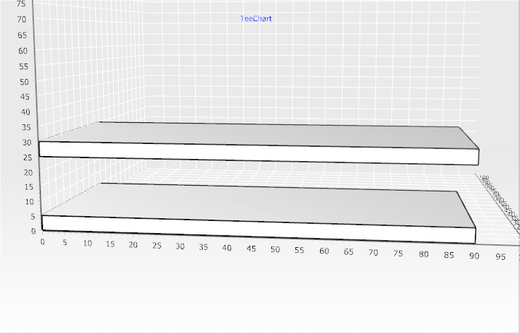

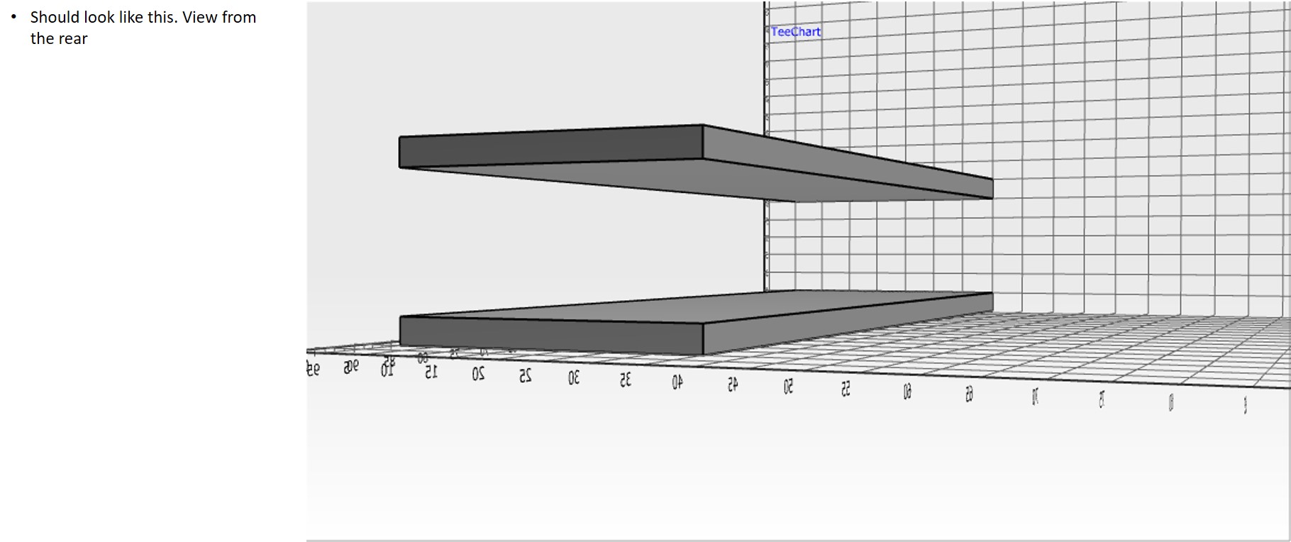

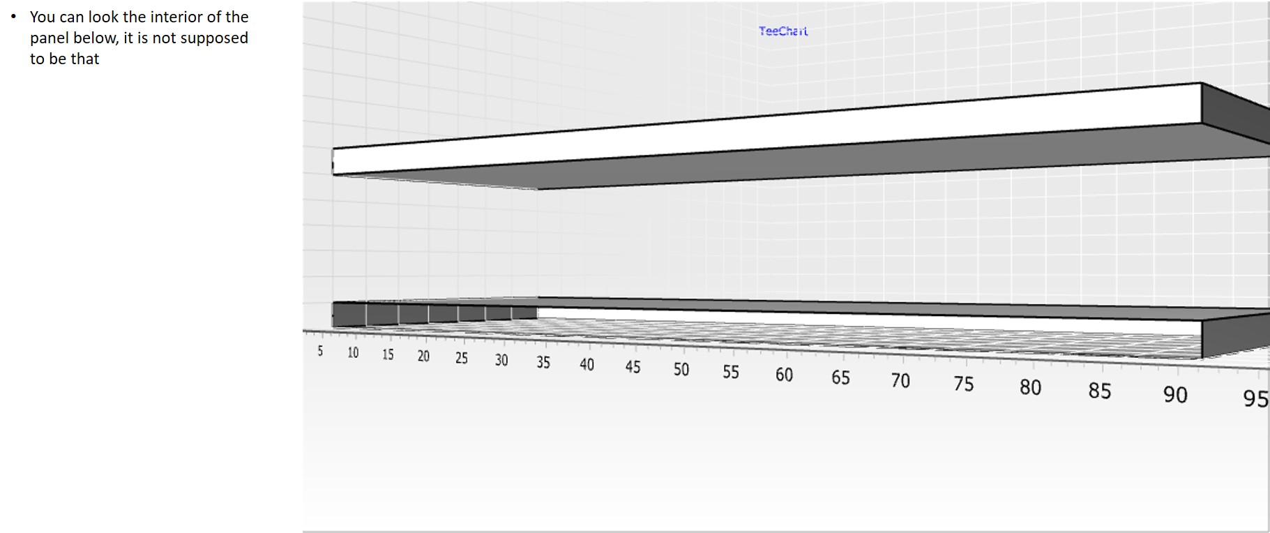

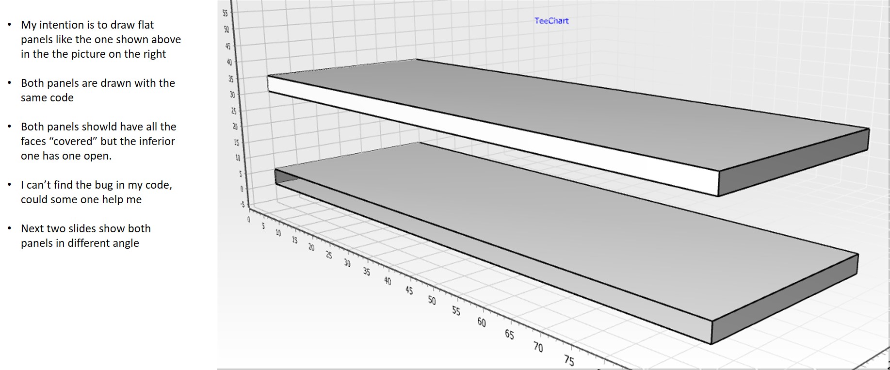

Hi!
I'm trying to draw boxes in 3D using tee Chart 2021 in VBA EXCEL.
Wall boxes have 3 dimensions, height, width and thickness. I'm doing
fairy well till now. But I'm facing a problem. I'm using canvas on_afterdraw methods
to make the wall surfaces opaque, but my code is not working completelly well.
Using the same code to draw two parallel walls, one of them is drawn perfectly,
all the sufraces (6 faces) are drawn opaque. The other one, only five of the six
faces are drawn opaque. I'm confused.
I've attached some pictures from different points
of view so you can watch the weird behavior of my code. I've also copied
the code below. To run it you have to insert a userform in VBA Exel and an instance
of the tChart control, and run it.
For simplicity, I've commented out some instructions, so just walls parallel to the
Left-bottom plane are drawn.
The teeCommander is linked to the chart so you can move, rotate, zoom it
Does any body has a hint that I can follow to solve my problem.
this is the code:

Re: Weird behavior drawing opaque surfaces in 3D in VBA Excel
Post by Yeray » Wed May 19, 2021 12:40 pm
Sorry for the delayed reply here.
This happens because you are drawing the planes in a specific order, which doesn't considers the rotation and elevation of the view and the position of the object.
Ie, when you look a cube from the front, you need to draw the back plane first, and the front plane later. However, when you rotate the view and you see the cube from the back, you need to draw the front plane first, and the back plane later.
What is more, when looking the cube from the front, you probable don't even need to draw the back plane at all.
However, when looking from the side, the front/back planes will be visible or not depending on the Z position of the cube and the distance to the observer.
And the similar should be considered with the top and bottom planes, this time depending on the elevation.

Thanks for your response.
Sorry, but I'm still confused.
If you see, both "bodies" are drawn with the same code, and the upper one does not show the weird behavior.
If I use the rotating tool, I can rotate the graph in every single direction and the faces of the upper body remains
opaque. They change the color because of the direction the ligth comes from.
Have you tried my code ...?
Is there another way to graph opaque planes in 3D?
Thanks ...
Post by Yeray » Thu May 20, 2021 11:05 am
Yes, I looked at your code. Now I looked at it again and indeed I was wrong and found what seems to be a bug in your code.
You are looping your series at OnAfterDraw event, but you are starting at series index 1, which skips the first series, which is corresponds to the first plane in your drawing. So changing that for to start at i=0 seems to solve the problem for me here:
    With TChart1
            For i = 0 To TChart1.SeriesCount - 1
I think it looks fine now:
