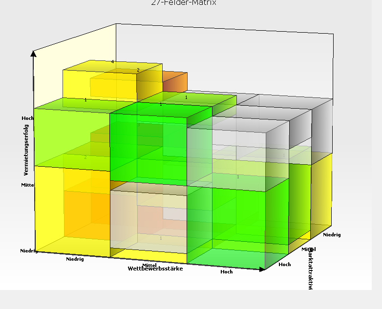

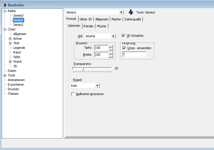

With the 2010 version the chart works fine. I have 3 series (3D) and each of them starts at its own defined origin (0,7,14). Origin 0 applies to "niedrig", origin 7 applies to "mittel" and origin 14 applies to "hoch" on the left axis.
The Chart with the 2010 version looks like the attached screenshot:

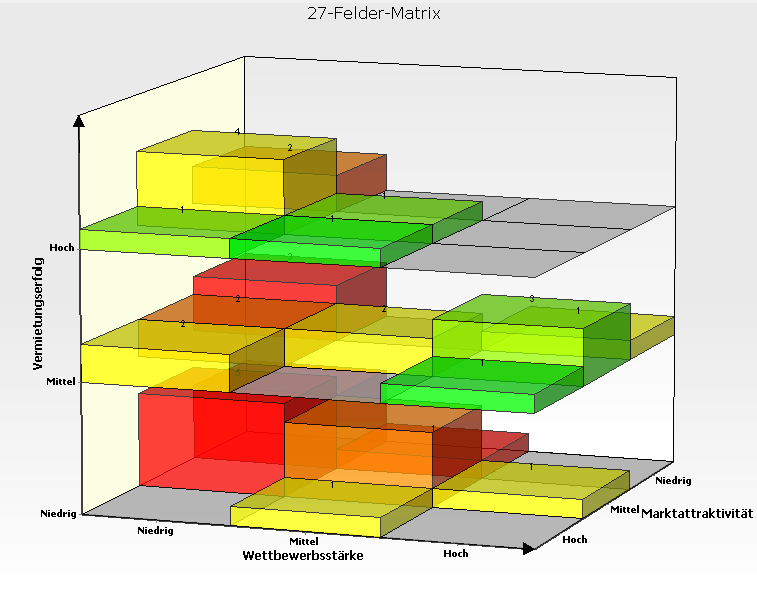

After migrating the chart to the 2016 version each tower of series1 (origin 7) and series2 (origin 14) goes from its y-value to 0 instead of going from its y-value to the series' origin.
The Chart with the 2016 version looks like the attached screenshot:
Which setting do I have to change in order to have the chart working with the 2016 version?

I reproduced the problem in TeeChart VCL (note TeeChart ActiveX is a wrapper from it) so I've added it to the public tracker:
http://bugs.teechart.net/show_bug.cgi?id=1718
I've also fixed so the next maintenance release should include it.

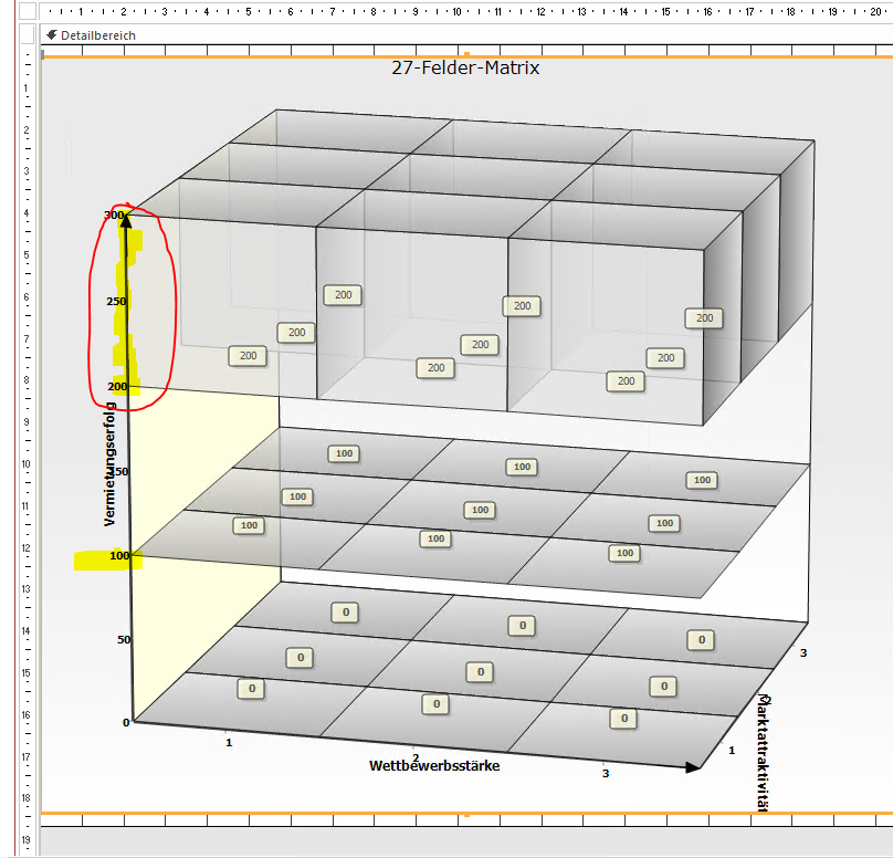

I still have some issues migrating a tower chart from teechart v.2010 to teechart v.2017 (activeX).
I have a tower chart with 3 layers (origin 1: 0, origin 2: 100, origin 3: 200). Layers 1 and 2 are working fine so far, but layer 3 behaves strange. Maybe you can help.
Layer 3 is set to start at origin 200 which is yet working correctly. But layer 3 is - in contrast to layer 1 and 2 - extending from 200 to 300 (left axis). I really need layer 3 to have the exact same behavior as layer 1 and layer 2. What settings do I have to set?

I could reproduce the problem so I've added it to the public tracker:
http://bugs.teechart.net/show_bug.cgi?id=1819
Note it's a TeeChart VCL bug that TeeChart ActiveX has inherited because the later is a wrapper of the former.
The last version not reproducing this problem is TeeChart ActiveX v2013.0.1.4

Hello Dominik,
Playing a little bit with the Origins I found a way to workaround it, at least for this situation:
Private Sub Form_Load()
Dim i, x, z As Integer
For i = 0 To 7
TChart1.AddSeries scTower
With TChart1.Series(i).asTower
.UseOrigin = True
If i < 2 Then
.Origin = 100 * i
Else
.Origin = TChart1.Series(i - 1).asTower.Origin + (TChart1.Series(i - 1).asTower.Origin - TChart1.Series(i - 2).asTower.Origin) - 100
End If
For x = 0 To 2
For z = 0 To 2
.AddXYZ x, 100 * i, z, "", clTeeColor
Next z
Next x
End With
Next i
TChart1.Axis.Left.SetMinMax 0, 800
End Sub
