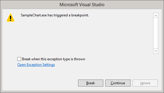

I haven't been able to reproduce the "2" abnormal message problem with that application.
The only message I see is a "SampleChart.exe has triggered a breakpoint" as soon as I close one of the multiple windows with 2 charts. Once it arrives, it continues showing over and over: Then, sometimes I also get a "Debug Assertion Failed" error: Changing your application from "Debug" to "Release" I can close all the windows without getting anyone of the above.
I can drag any of the windows without getting the "2" abnormal message both in Release and Debug modes.

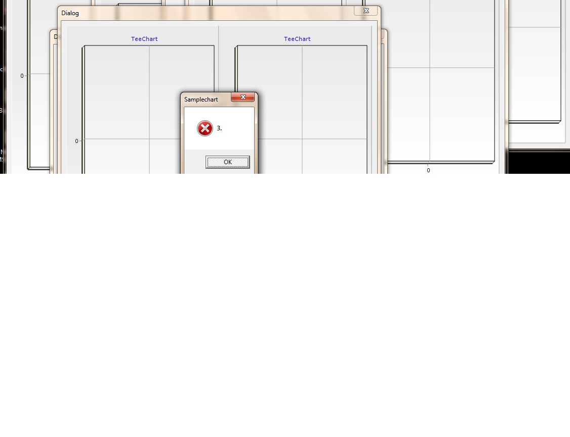

I just downloaded TeeChart2015_0_0_0_ActiveX3264.exe from your website, uninstalled the previous version, restarted the machine and installed the new version. When I ran the demo application and dragged the windows there were no '2." message boxed but I came across a message box with "3." written inside (refer to the attached screen dump). The frequency of this message box is less than that of "2" and the same exception was reported on the output window.
Just to let you know that we are going to have an important delivery shortly and this message box issue has to be resolved before that and we have no solution for it. Please look into the issue and let us know how to fix.This is urgent!

Any update to my last response? Please let me know if you can reproduce the same ("3." message box) on your end and if so why are these message box appearing.
Another observation is that for each graph control if I set auto repaint false after it is created I don't find any message box. Check if auto repainting the graphs has anything to do with these message box in a multi-threaded environment.
Also if I set auto repaint false how do I update and draw the graphs?

If you can confirm it is only reproducible in GDIPlus, it can serve you as a temporal workaround while we continue investigating for a permanent fix.
Try switching from GDIPlus to GDI to check if the problem is only reproducible in GDIPlus:Yeray wrote:We could reproduce the problem and we found the origin of the problem. At the moment we are investigating what alternatives we have to fix it.
We'll be back to you as soon as we find it.
pchart_->GetAspect().GetGDIPlus().SetActive(false);

Setting GDIPlus active to false indeed resulted no further "3." message box but the graph display quality is very poor. Most of the times the graph controls are not painted properly. Although it fixes the core issue but the graphs will be useless from user point of view. Please suggest.
Asit
