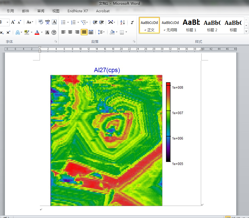

Hi,Yeray,
I pasted an image after I insert my image created with colorgrid into word.How can I clear the right and bottom border?
Robinson
insert image to word
Re: How to clear border color or set it white?
Post by Yeray » Mon Apr 14, 2014 7:50 am
Try with:
Chart1.BevelOuter:=bvNone;
http://www.teechart.net/support/viewtop ... el*#p60149

Post by zrandlbs » Mon Apr 14, 2014 9:44 am
Hi, Yeray,
Thank you.It works well.
