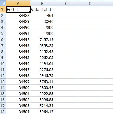

I reviewed the demo and I've searched in the forum but I cannot export to excel as a date format, it continues exporting as a number (See attached file Fecha_Ventas.jpg)
I am using the following code with TeeChart8.ocx:

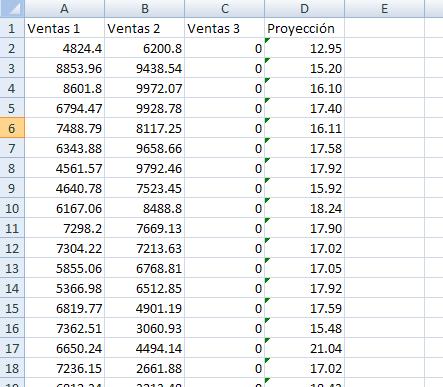

Additionally, now I have a new problem: I have three series referring to the x and y axis (left), and one serie with the x and y axis (right). All series in the same chart. The 3 axes are numerical (bottom, right, left); when I exported to excel only the y-axis coordinates are exported, how can I export the x-axis values? (See attached file 2_ejes_y.jpg)

- The x-axis isn't exported
- 2_ejes_y.jpg (41.37 KiB) Viewed 17761 times
- First column must be a date format
- Fecha_Ventas.jpg (29.26 KiB) Viewed 17761 times

Have you seen the summary here of the possibilities available?JAV wrote:I reviewed the demo and I've searched in the forum but I cannot export to excel as a date format, it continues exporting as a number (See attached file Fecha_Ventas.jpg)
Have you added XValues? If you use the Add method (so you don't add XValues) the XValues will be 0, 1, 2,... and they won't be exported.JAV wrote:Additionally, now I have a new problem: I have three series referring to the x and y axis (left), and one serie with the x and y axis (right). All series in the same chart. The 3 axes are numerical (bottom, right, left); when I exported to excel only the y-axis coordinates are exported, how can I export the x-axis values? (See attached file 2_ejes_y.jpg)
However, if you use the AddXY method to add XValues manually, they seem to be exported correctly for me here:

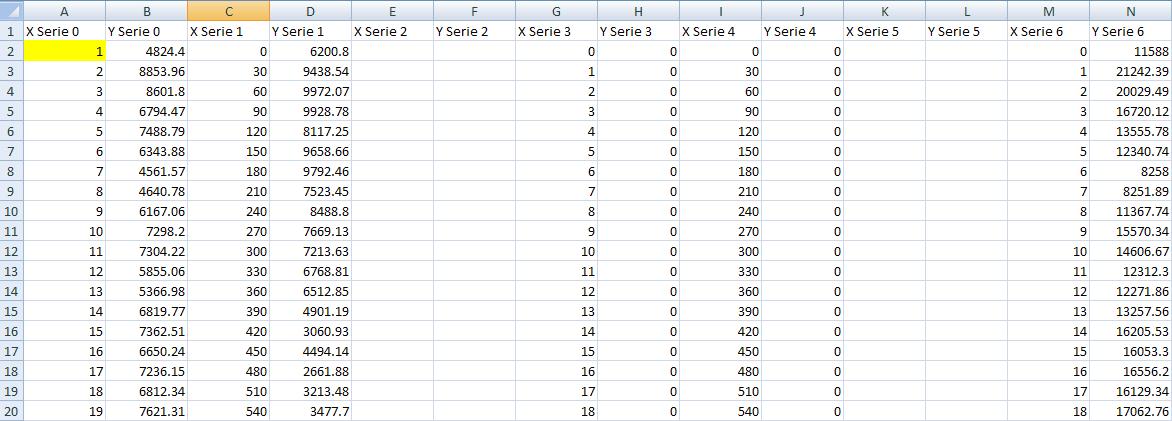

We did what you suggested, we export a serie at once but it didn't work. In this case only one column, Y axis values, was exported.
Just for trying, we increased in 1 each X value of serie 0 and with this change this were successfully exported. Even when exporting all series in the chart with this modification, entire series were exported properly, as shown in the attachment, but column A should be identical to column G, ie it must start at 0. What could be happening? Please note that if serie 0 in X axis starts at 0 we get any column X in every series exported.

- Solution.JPG (97.64 KiB) Viewed 17695 times

I think the problem is that, when the first series has XValues 0, 1, 2, 3, ..., the XValues aren't exported for any series, even when the other series have different XValues. This possibility will be investigated when the ticket TV52015617 will be addressed.
