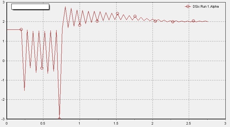

First, if I switch the legend position from left to right (or vice-versa) the *rectangle* changes position but the text and legend symbols do not. See figure A. The legend appears correctly the next time the plot is repainted.

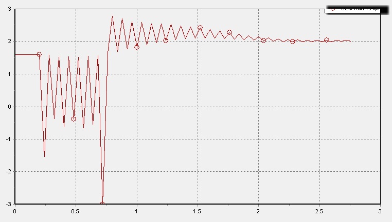

Secondly, if the user chooses to place the legend outside of the plot boundary then only the portion of the legend still drawn *inside* of it is displayed. The rest appears as a black rectangle. See figure B.

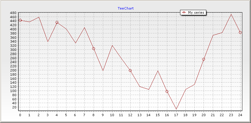

And here it is the chart I'm getting:
Note that in the event I'm taking and using the values given as parameters in the same (to calculate the width and height). But the event will only give the "correct" values once the chart has been drawn at least once. That's why I'm forcing a redraw (TChart1.Environment.InternalRepaint) before setting TChart1.Legend.CustomPosition = True.
So the code above doesn't seem to reproduce the problem for me here. Could you please try to modify the code above so we can reproduce the problem here?
