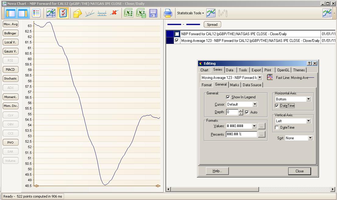

I have an issue about the following scenario :
I create a graph by associating a moving average and then I turn off the main graph and I have no dates on the x-axis, so that when I open the Editing window, I flip the horizontal axis at the top, i perceive the dates, otherwise I see nothing on the bottom axis.
Thx

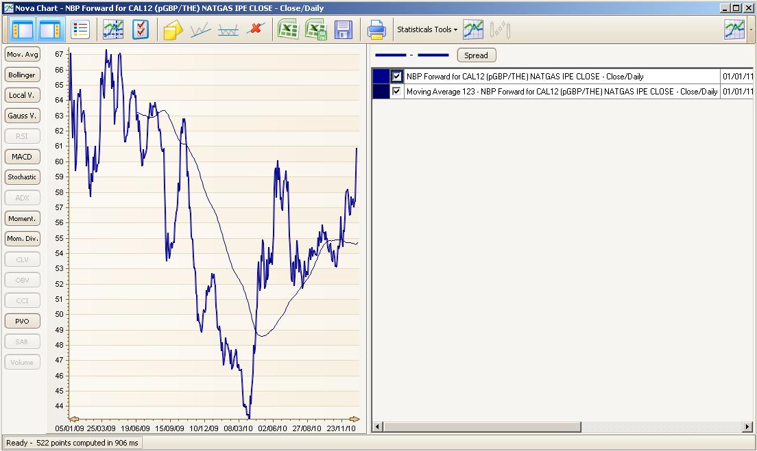

My issue is the following :
Initially, we had a main graph and moving average associated function :
And when we deselect the main graph, we have the following situation (we can't see X-values on the bottom axis) :
