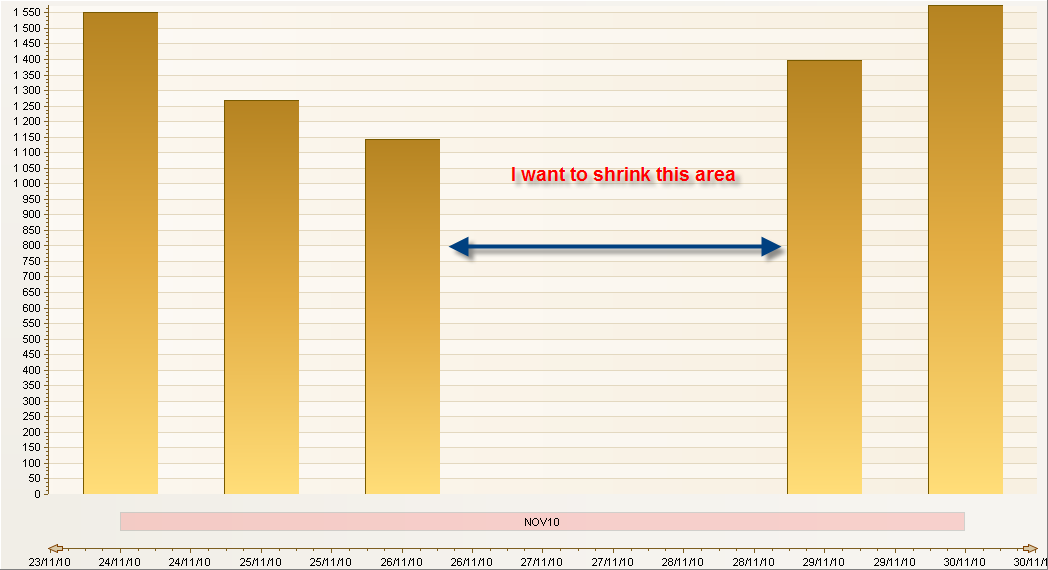

I have a problem with bar charts. I have values only on working days and wish to plot only that data (without weekends).
Hereafter is a sample of my code:
With AxTChart
	.AddSeries(TeeChart.ESeriesClass.scBar)
	.Series(IntSerie).asBar.BarStyle = TeeChart.EBarStyle.bsRectGradient
	.Series(IntSerie).XValues.DateTime = TRUE
	.Series(IntSerie).asBar.BarWidthPercent = 100
End With
For i = 0 To oData.Count - 1
       eElement = oData.Item(i)
	AxTChart.Series(IntSerie).AddXY(DateValue(eElement.Date).ToOADate(), eElement.Value, "", AxTChart.Series(IntSerie).Color)
Next i
If I 'm using above code I will have Friday Bar larger 3 times the others bars, because it includes Saturday and Sunday, even though they are null values.
If I force Sunday and Saturday values to be 0 or Nothing , Friday Bar will be OK, but there will be a gap between Friday and Monday.

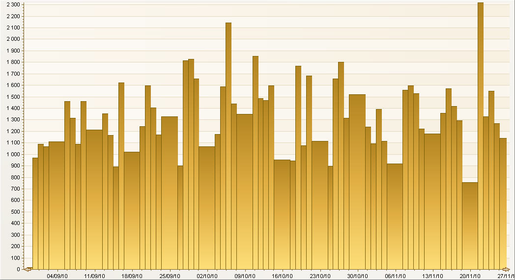

Examples
Data without weekends(null). Friday bar too large
Data with weekends values forced to 0

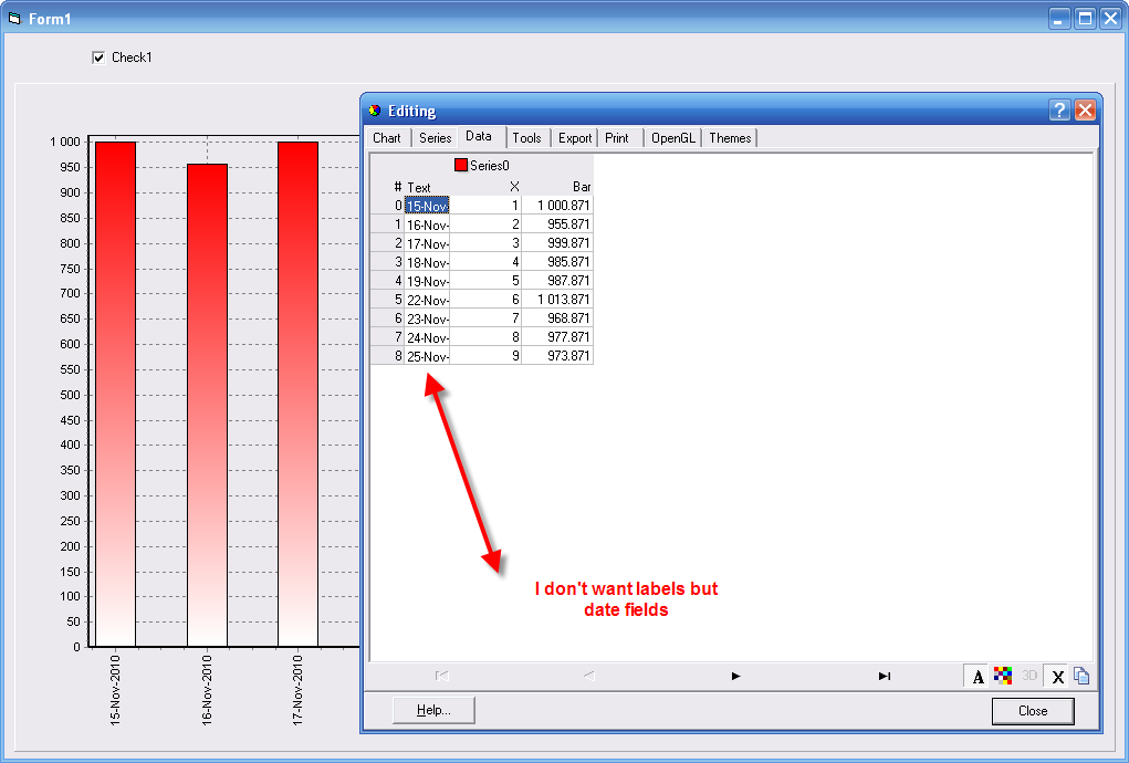

Hi Sandra,
as I mentioned in my 1st post:
"...I was inspired by a solution in the forum to change Series(IntSerie).XValues.DateTime to FAlse and add points AS 1,2,3 ....
with dates as corresponding labels, but this will cause problems in my tool.."
and so I cannot use your solution:
      .XValues.DateTime = False
      .AddXY 1 + t, tmpopen, "", vbRed
      .PointLabel(t) = myDates(t)

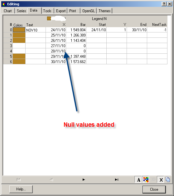

It's not working for me:
I cannot understand what I'm missing. I add Null values on weekends,
but I still see week-end dates and gap between friday and monday. Hereafter a sample code:
With AxTChart
	.Series(0).asBar.Gradient.Visible = True
	.Series(0).asBar.BarStyle = TeeChart.EBarStyle.bsRectGradient
	.Series(0).asBar.BarWidthPercent = 60
	.Series(0).Marks.Visible = False
	.Series(0).XValues.DateTime = True
end with
AxTChart.Series(0).AddXY(Math.Round(DateValue("26/11/10").ToOADate(), 0), 120, "", AxTChart.Series(0).Color)
AxTChart.Series(0).AddNullXY(Math.Round(DateValue("27/11/10").ToOADate(), 0), 0, "")
AxTChart.Series(0).AddNullXY(Math.Round(DateValue("28/11/10").ToOADate(), 0), 0, "")
AxTChart.Series(0).AddXY(Math.Round(DateValue("29/11/10").ToOADate(), 0), 150, "", AxTChart.Series(0).Color)
Any idea? Can you give me an example?

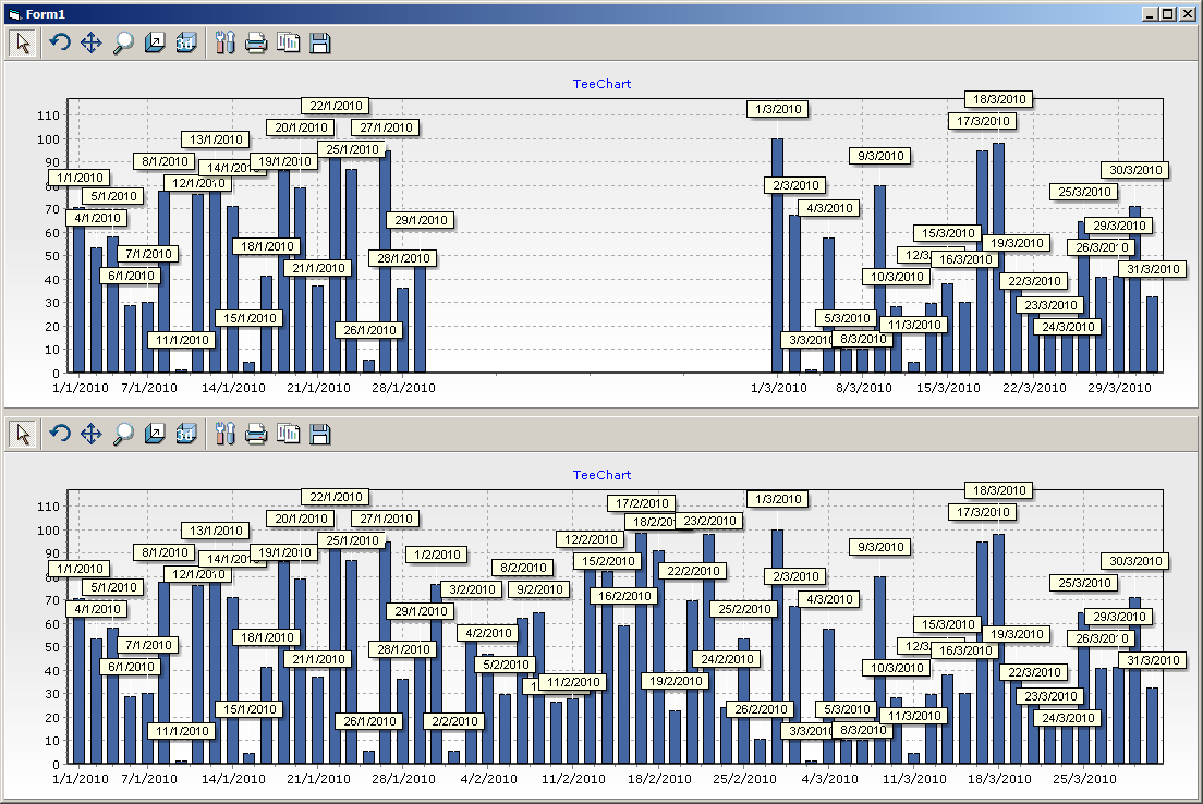

Post by Yeray » Thu Dec 02, 2010 9:11 am
Hi User1,
Adding values with AddXY method gives you the opportunity to control where exactly in the axis will be drawn each bar. And I think that's what you need.
If you set the bottom axis to be DateTime, you still have to control the separation between one bar and the next one as DateTimes are in fact doubles. It's the expected behaviour to see more separation between two bars with a weekend increment in XValue than between two consecutive days bars.
Adding the date as XValue (or adding Null values), doesn't allow you to control this separation. That's why I recommend you to use a variable to control the XValue and increment its value in one unit from Friday to Monday, the same as from Monday to Tuesday.
And when you want to add a gap between bars (for example to showing that there is no data in a month) you simply have to increment the XValue in more units.
Private Sub Form_Load()
  TeeCommander1.ChartLink = TChart1.ChartLink
  TeeCommander2.ChartLink = TChart2.ChartLink
  TChart1.Aspect.View3D = False
  TChart2.Aspect.View3D = False
  TChart2.Legend.Visible = False
  TChart1.AddSeries scBar
  TChart2.AddSeries scBar
  Dim XValue, YValue As Double
  Dim i As Integer
  Dim myDate As Date
  XValue = 0
  myDate = DateValue("01/01/2010")
  For i = 0 To 89
    If Weekday(myDate) <> vbSaturday And Weekday(myDate) <> vbSunday Then
      YValue = Rnd * 100
      If Month(myDate) <> 2 Then
        TChart1.Series(0).AddXY XValue, YValue, Str$(myDate), clTeeColor
      End If
      TChart2.Series(0).AddXY XValue, YValue, Str$(myDate), clTeeColor
      XValue = XValue + 1
    End If
    myDate = myDate + 1
  Next i
  TChart1.Environment.InternalRepaint
  TChart2.Environment.InternalRepaint
  TChart1.Series(0).asBar.BarWidth = TChart2.Series(0).asBar.BarWidth
End Sub
So adding the following to the code above doesn't affect the result:
  TChart1.Series(0).XValues.DateTime = True
  TChart2.Series(0).XValues.DateTime = True
If you need a more precise example, please try to arrange a simple example project we can run as-is to reproduce the behaviour here, showing us something similar to the two charts you are trying to obtain and the tool you are using.
