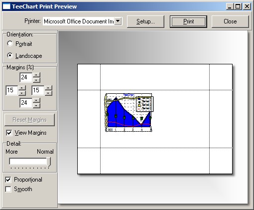

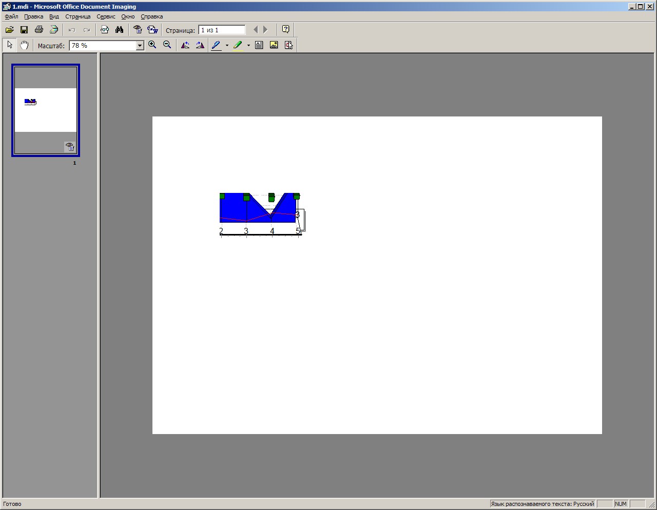

I am using CustomChartRect=true and ChartRect() to set chart bounds to fixed numbers. Everything is OK, except when I want to print the chart.
It seems that custom ChartRect coordinates do not add up with the print margins, so the chart is placed in the left-top corner of the page with no regards to margins, which causes chart clipping. I guess I have to add manually print margins to the ChartRect coordinates before printing and subtract them after printing, but I cannot find the correct values.

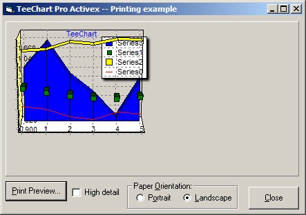

You can easily replicate this issue, by modifing "Examples\Visual Basic\Visual Basic 5 & 6\Printing" by adding to the Form_Load something like
TChart1.CustomChartRect = True
TChart1.ChartRect 10, 10, 210, 160
As you can see from attached screenshots, everything looks OK on the print preview page, but the actual print result is incorrect.
Any ideas on how to print this chart correctly?
Regards, Danil.
The actual print result (shown in Microsoft Office Document Imaging)
Print preview
Modified "Printing" example
