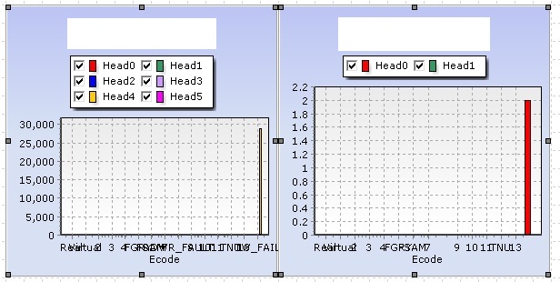

But I still have one problem for Text Label.
When I use many Text Labels, they seem to be stacked.
Text labels stacked on bottom axis
What I want to say is that there wasn't this problem in TeeChart 8.0.0.8.
In TeeChart 8.0.0.8, it automatically shows text labels not to be stacked.
How can I resolve this problem?
Please let me know.
Thank you.
Re: Teechart v2010 dense bottom axis values.
Post by Sandra » Mon Oct 25, 2010 11:01 am
Hello Michael,
You are right. It is a known bug for us I've incremented the ticket priority (TV52015179).
