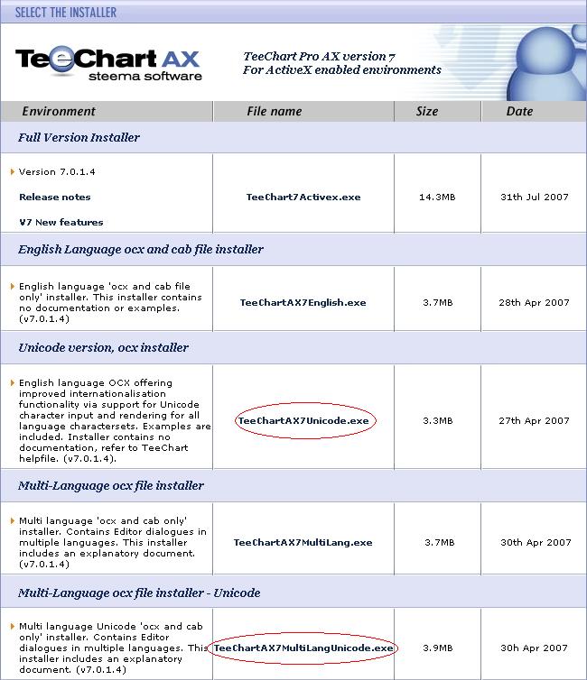

Post by Narcís » Fri Dec 18, 2009 8:07 am
Hi cwdave,
I'm sorry but I can not post product direct download links in a public forum. Anyway, I can see unicode version installers in TeeChart Pro v7 ActiveX download page. They are right below the standard and English installers as you can see in the image below.

The readme notes from TeeChartAX7Unicode.exe say this is a "Test version only. Not recommended for production use". Is there another version for production?
Re: Chinese / unicode support in ActiveX version 7.0.1.4
Post by Narcís » Tue Dec 22, 2009 8:48 am
Hi SVMan,
This must be an error. You can use this version for production purposes too.
